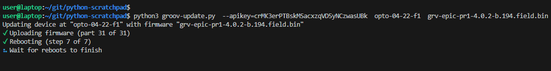

For example, on Linux:
python3 groov-update.py 192.168.137.22 /home/opto/grv-epic-pr1-ignition7-3.6.0-b.32.field.bin --apikey=DjV43UWfNoChHKkPZaebwjacH8w3Pvmx

    print(f'Updating device at "{cmd_args.address}" with '
          f'firmware "{cmd_args.firmware}"')
